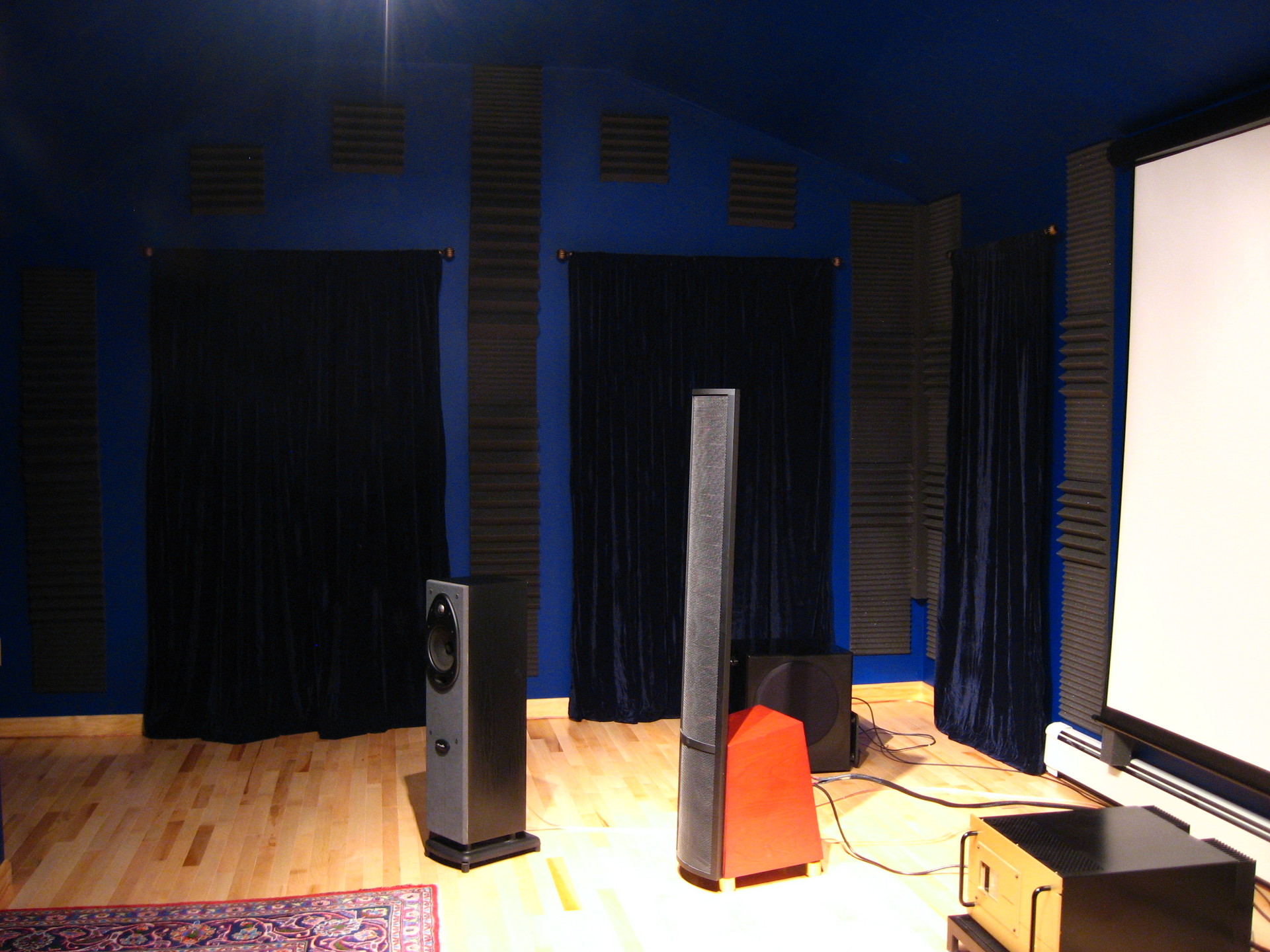

I built this room from planning stage to completion in about 6 months with most of the work being done in a 3 week period near the end. As I have made changes I moved older pictures into the "Previous Setup" gallery (but not all). Comments are welcome!
The above pictures still shows my old Martin Logan speakers. Look at the end of this gallery to see the new Magnepan 20.1's.

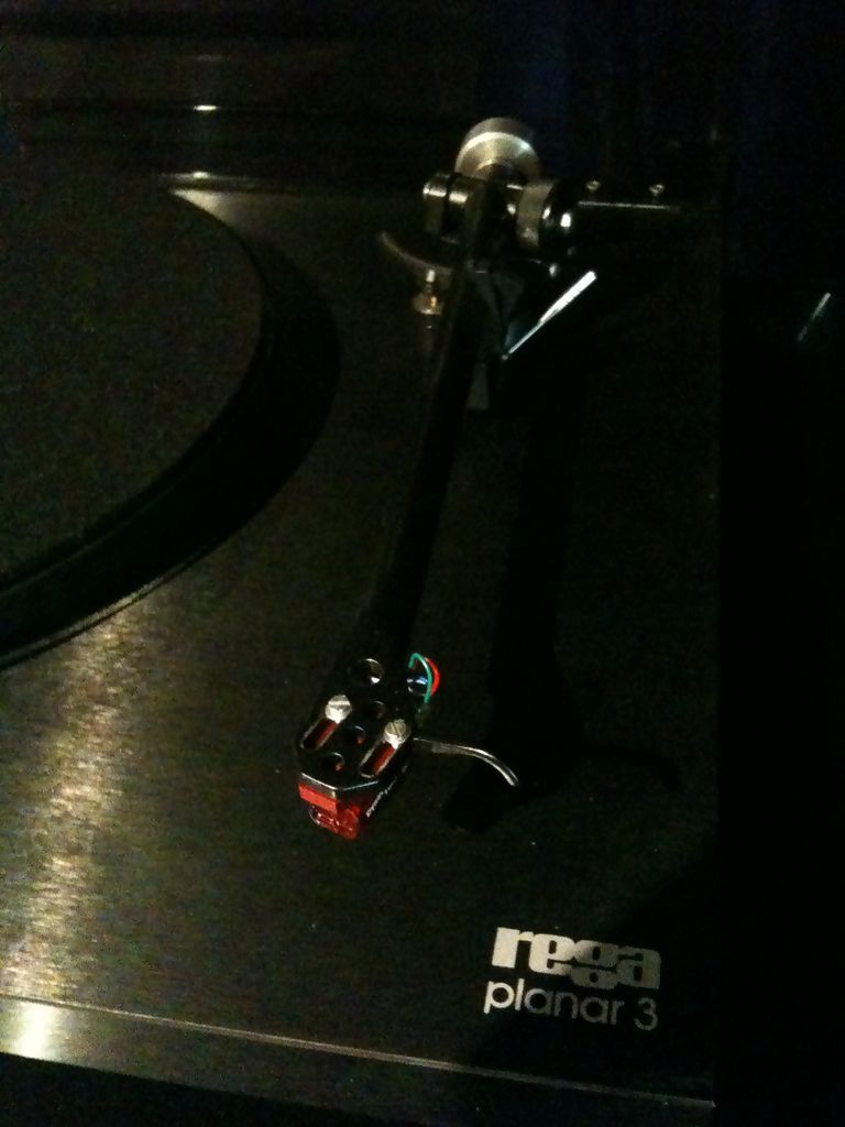

Rega Planar 3 Turntable (Rega RB300 Tonearm. Dynavector 10X5 cartridge. Monster RCA connector upgrades.)

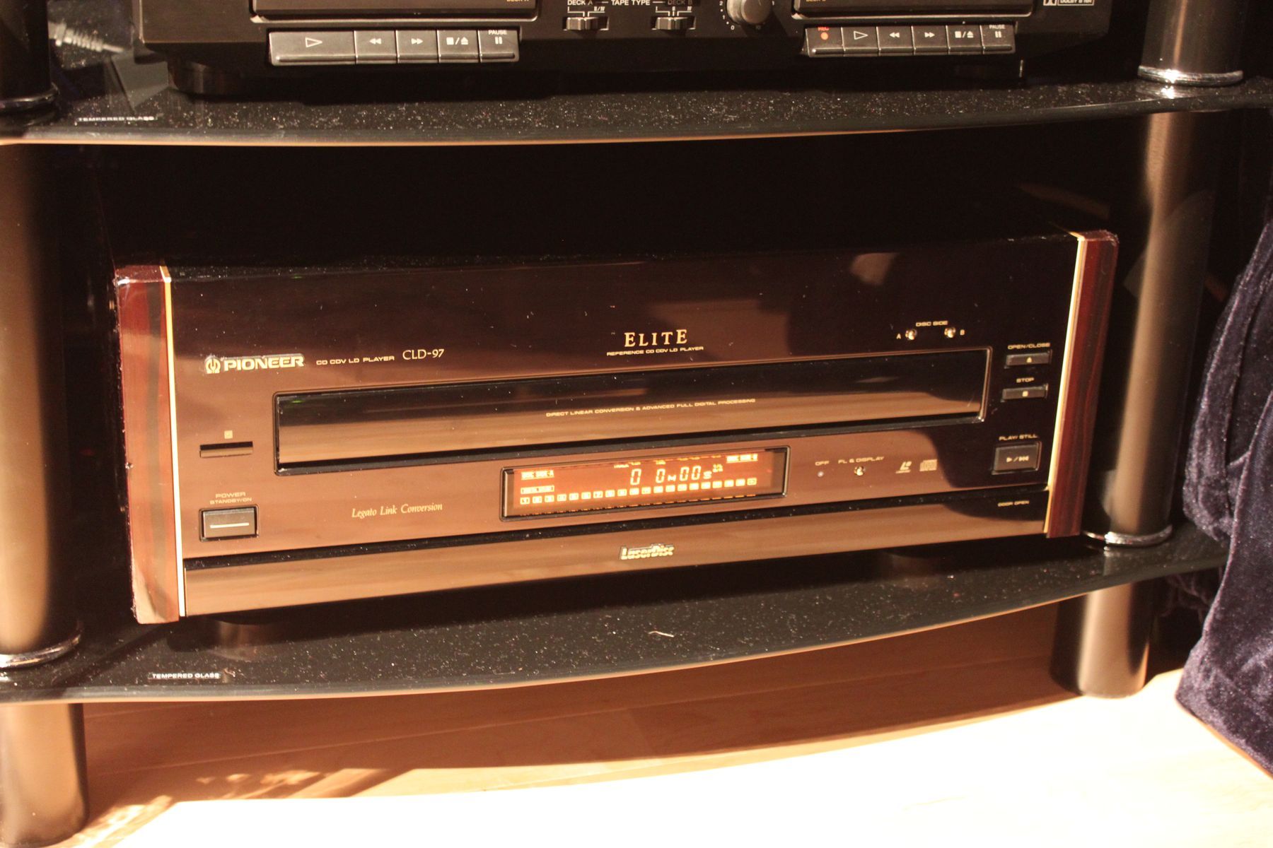

Pioneer Elite CLD-97 Laserdisc Player (with AC3 output mod and DNR Auto-off mod)
Pioneer Elite CLD-97 Laserdisc Player (with AC3 output mod), backup player

The room is approximately 24 x 23 feet with vaulted ceilings and approximately 150 12"x12" sound proofing panels and additional corner base traps to minimize perpendicular surfaces and distortion.

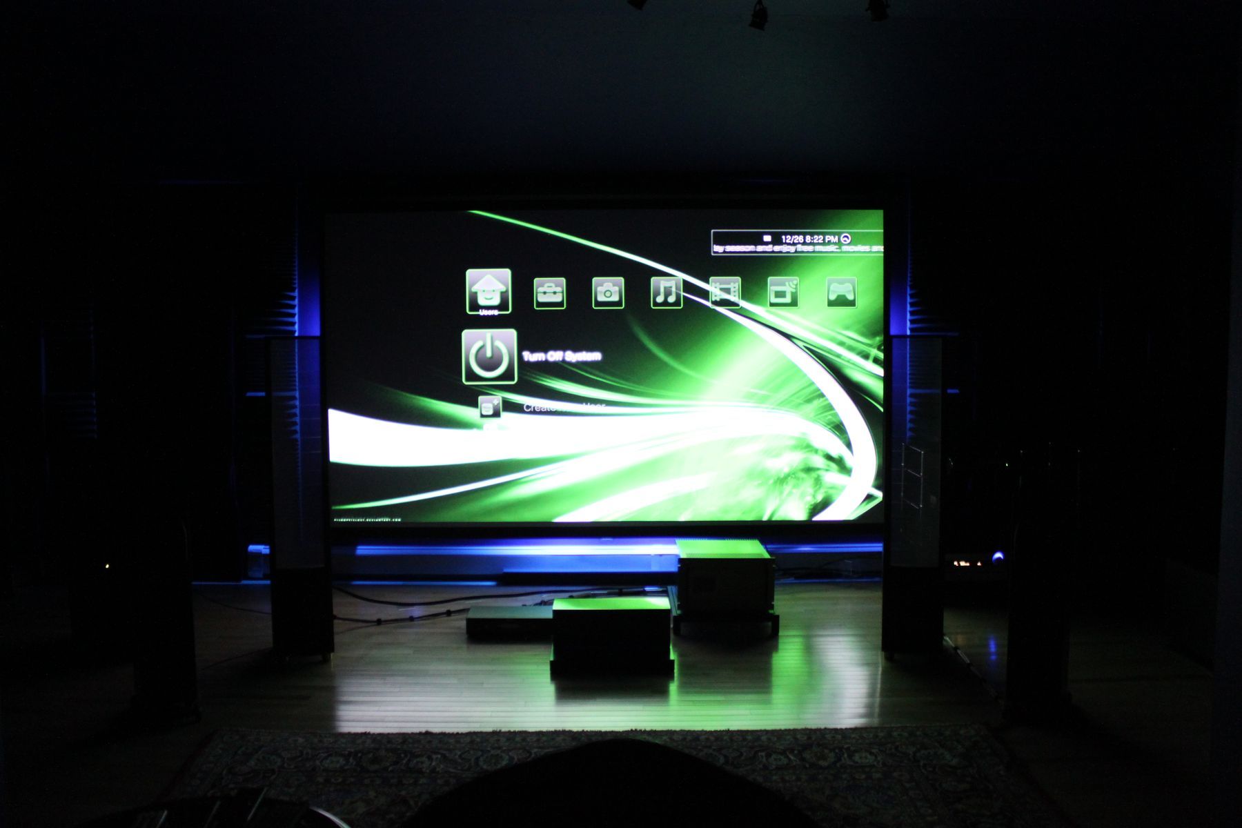

In the dark!

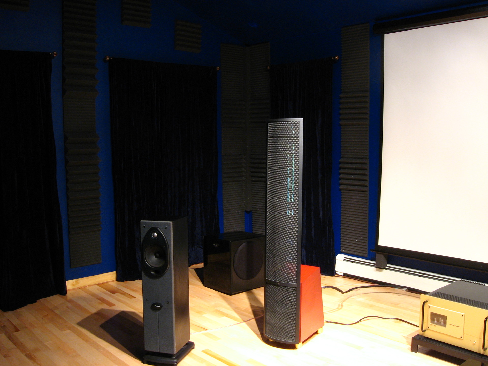

There are about 150 1x1 ft soundproofing panels in the room that I mounted one at a time (that took awhile!).
Uploaded Dec 28, 2011 17:25:26
Uploaded Jun 01, 2011 14:35:40
Side wall with sound proofing treatment.

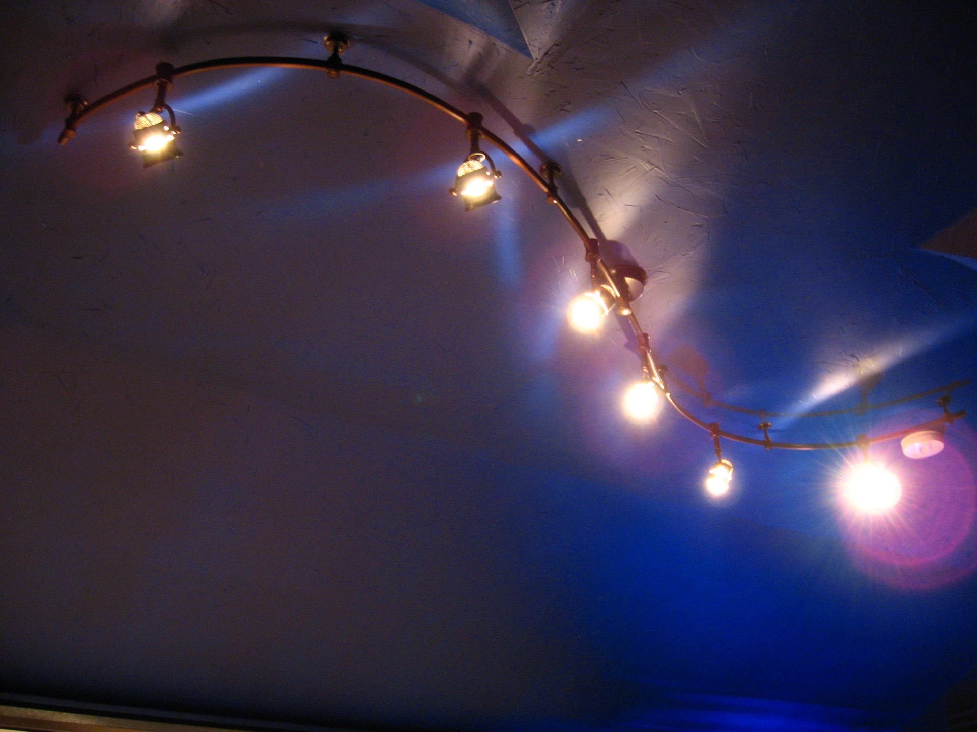

Dim controlled overhead lighting.

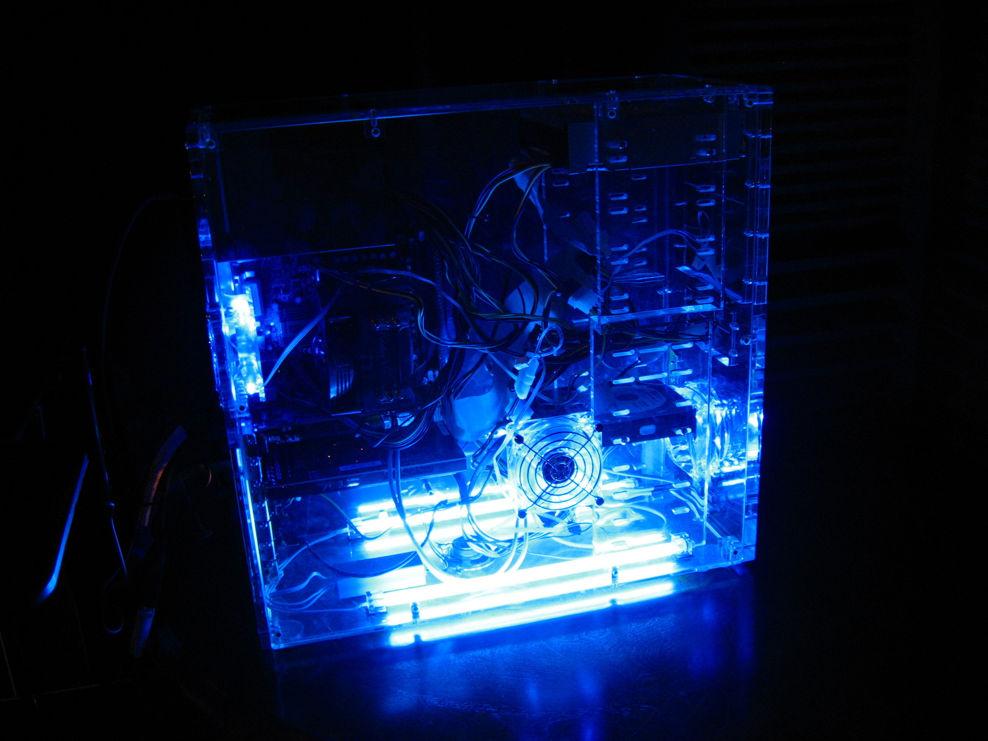

Media center with acrylic case and lighting.

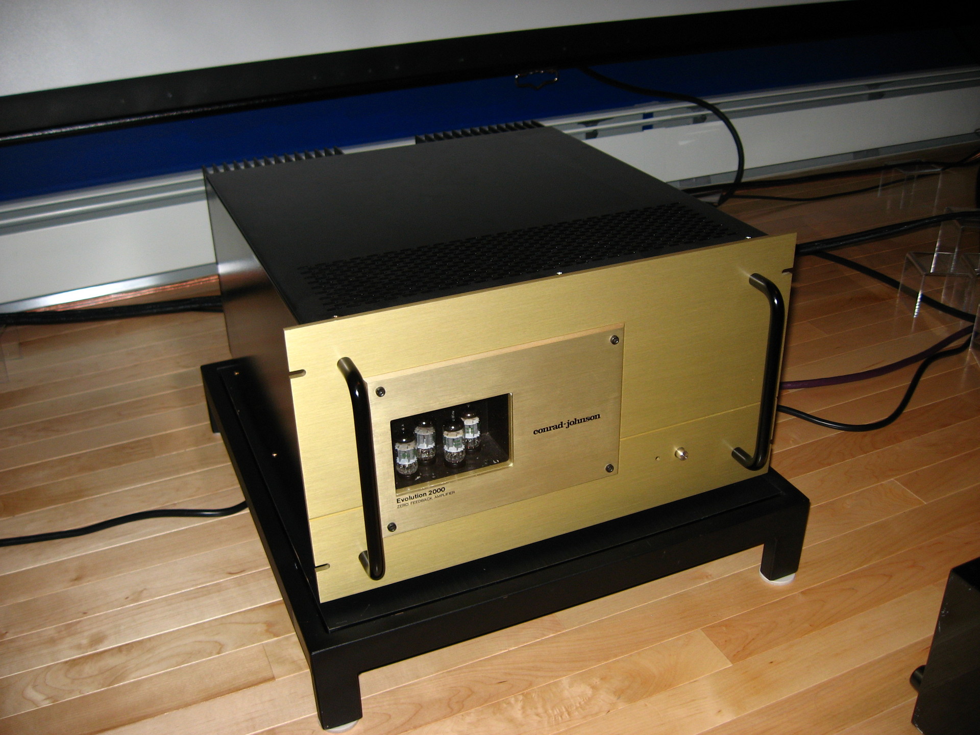

Conrad Johnson Amp. It weights 115 lbs,... needed some help getting it into position. I have it sitting on 4 audiophile jelly feet (not pictured) on the amp stand.

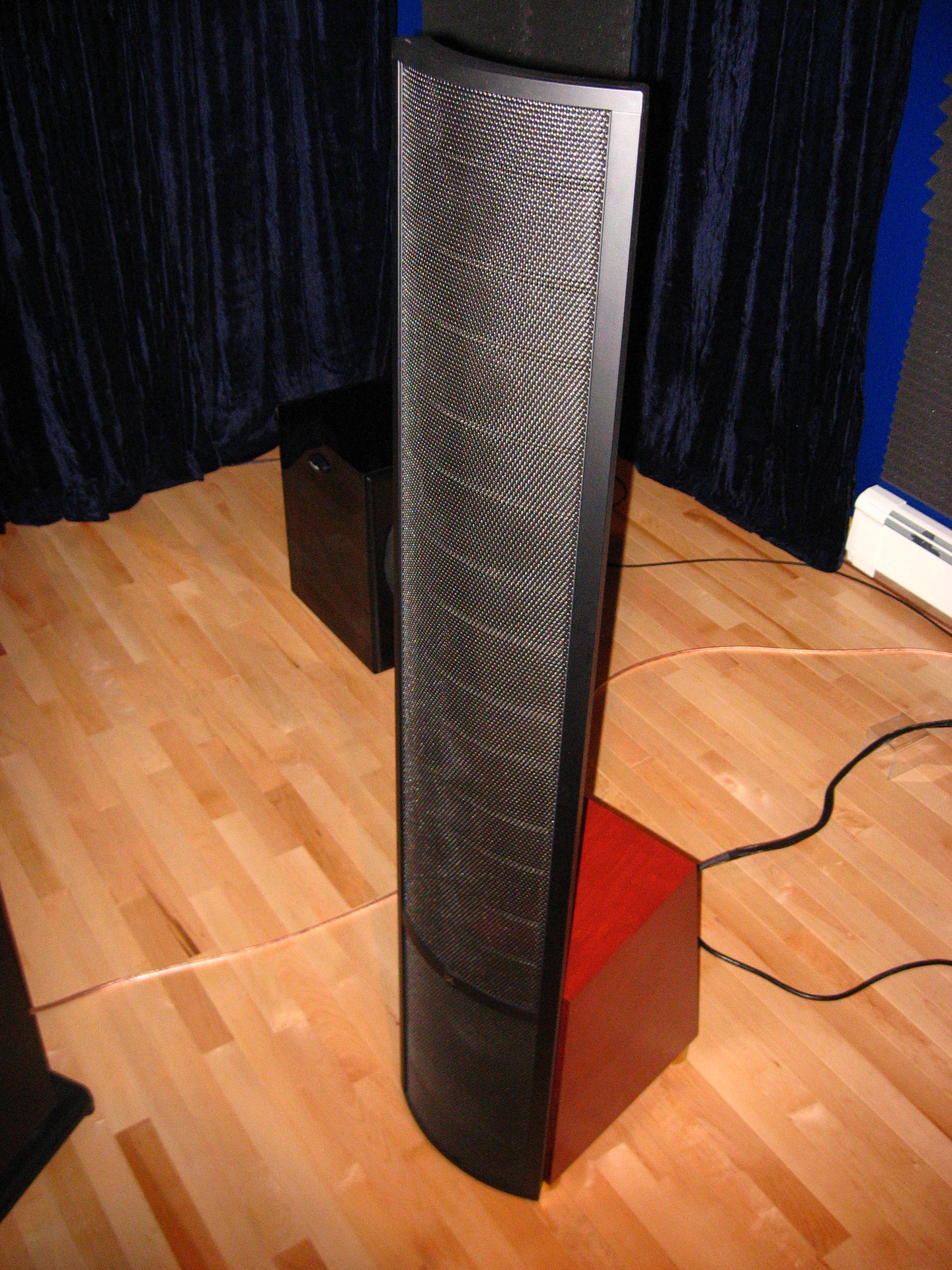

Martin Logan Speaker.

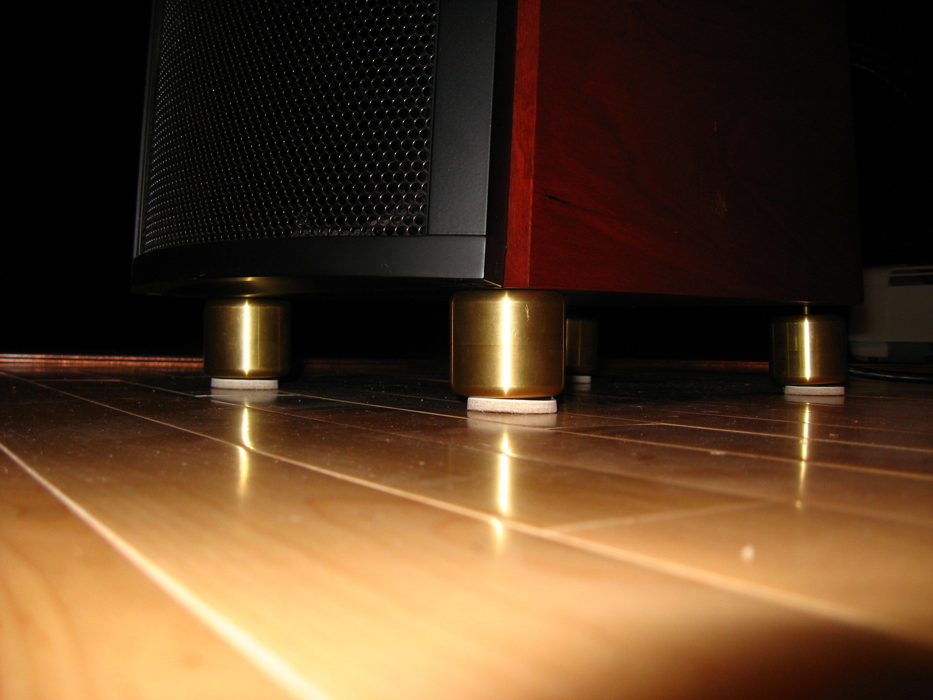

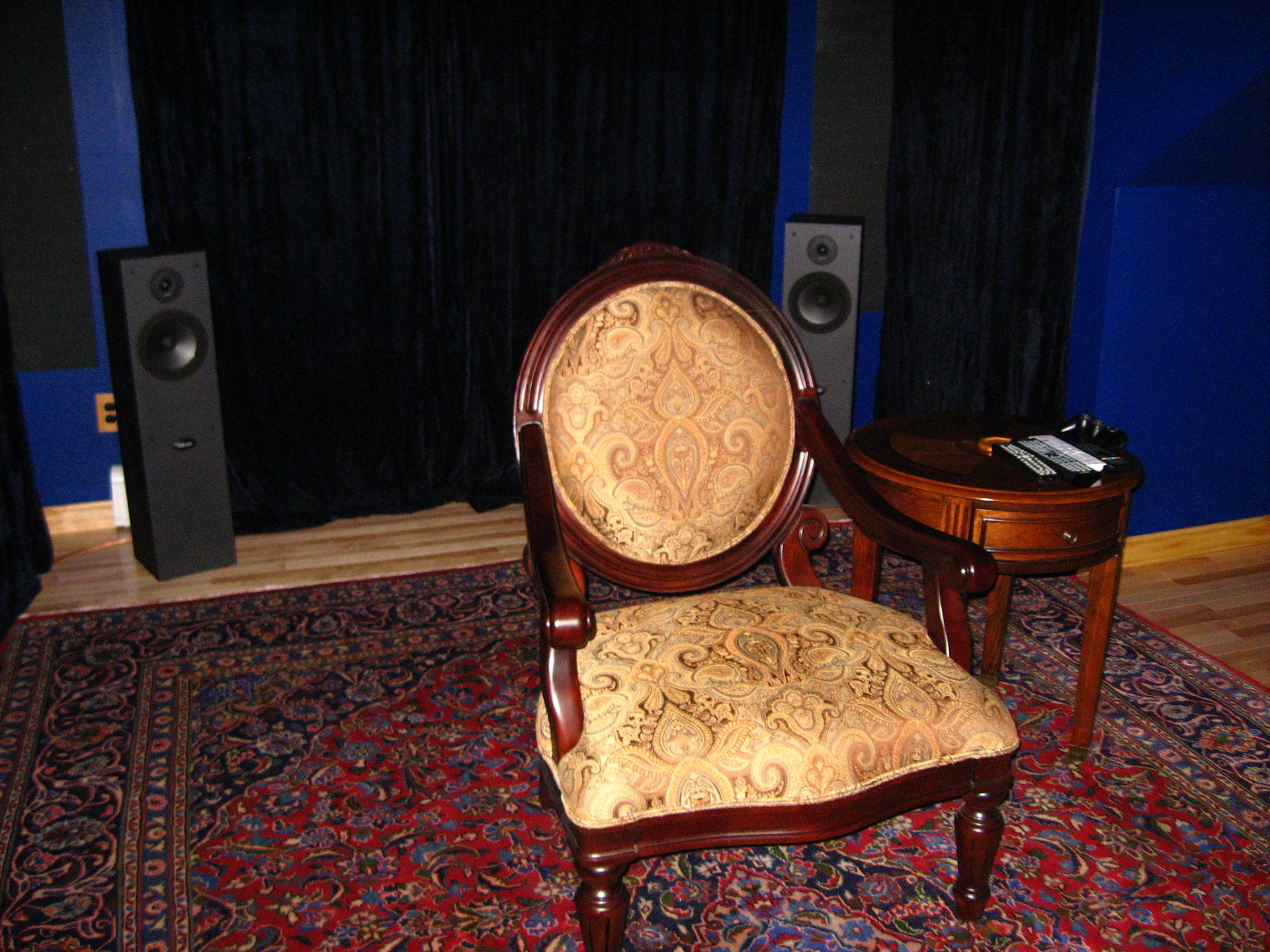

Custom feet for speakers.

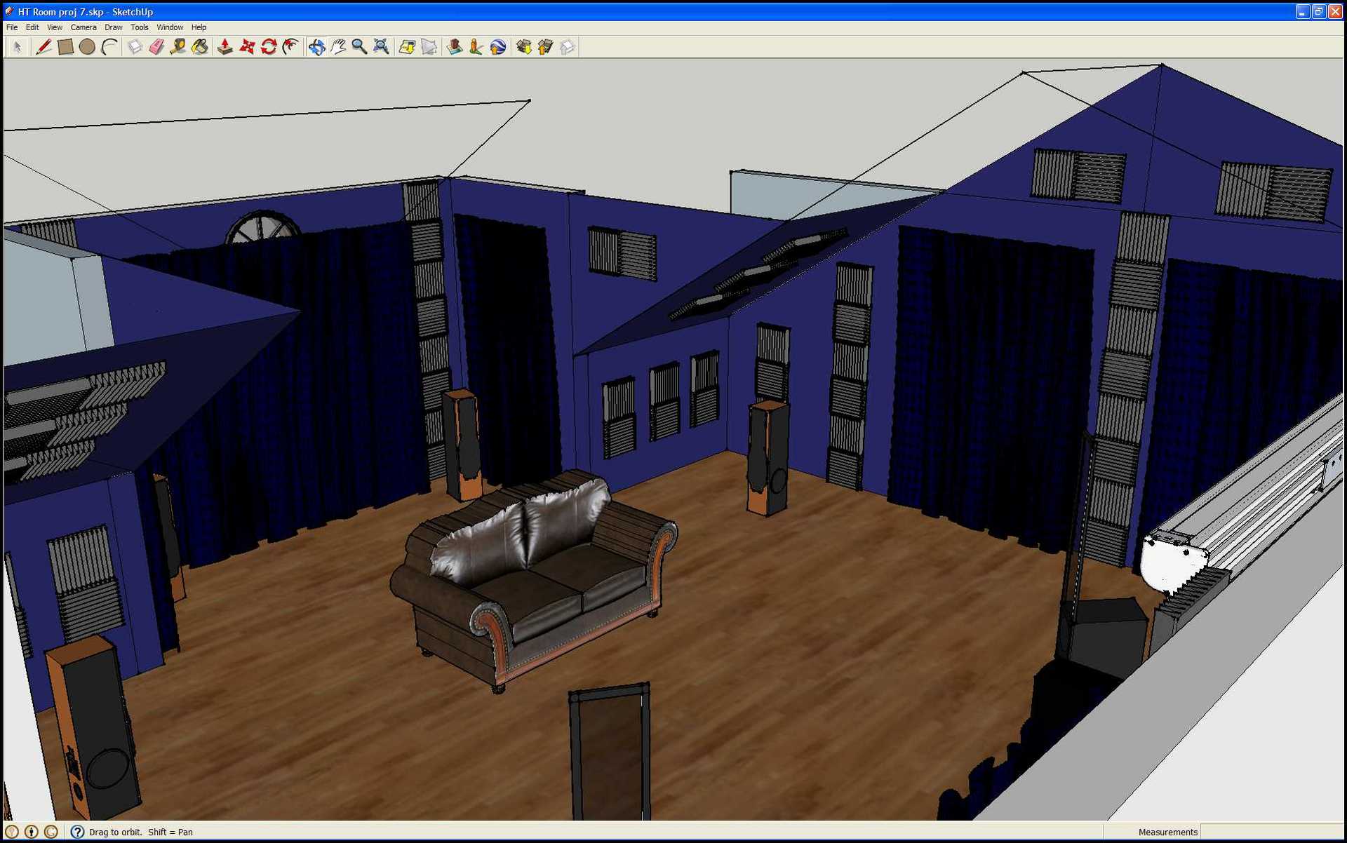

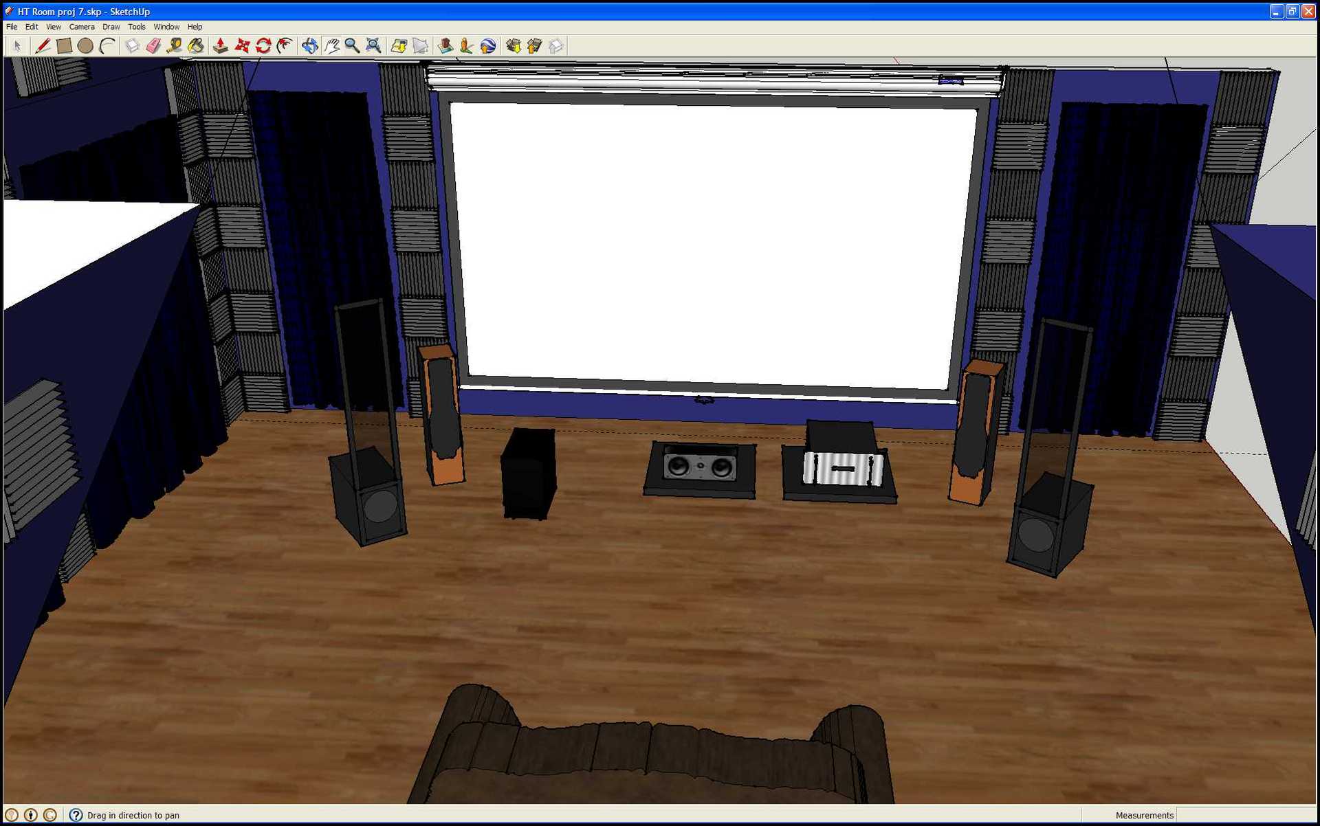

Initial plan before room build.
Uploaded Jun 01, 2011 14:40:47

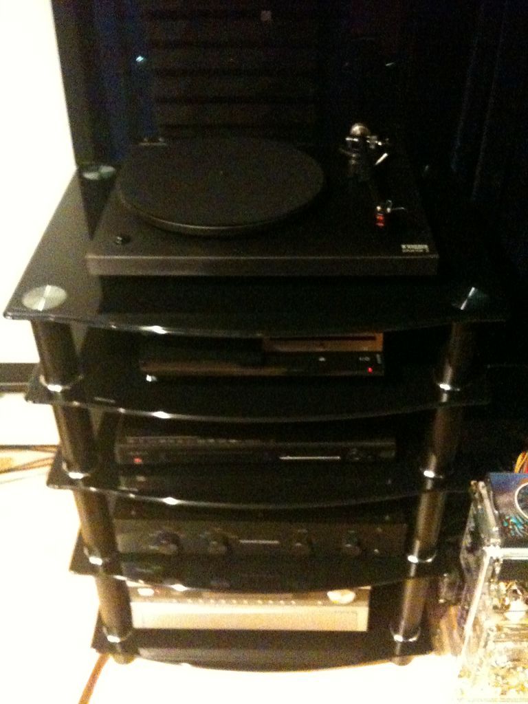

Bought 2 of these to replace my current audio rack. I want to get the receiver off the floor and into the rack, and I also want to move the laserdisc player to a lower shelf. Hopefully this will give me the space I need. I will post pics once I have it all set up.
Uploaded Oct 09, 2011 14:47:19

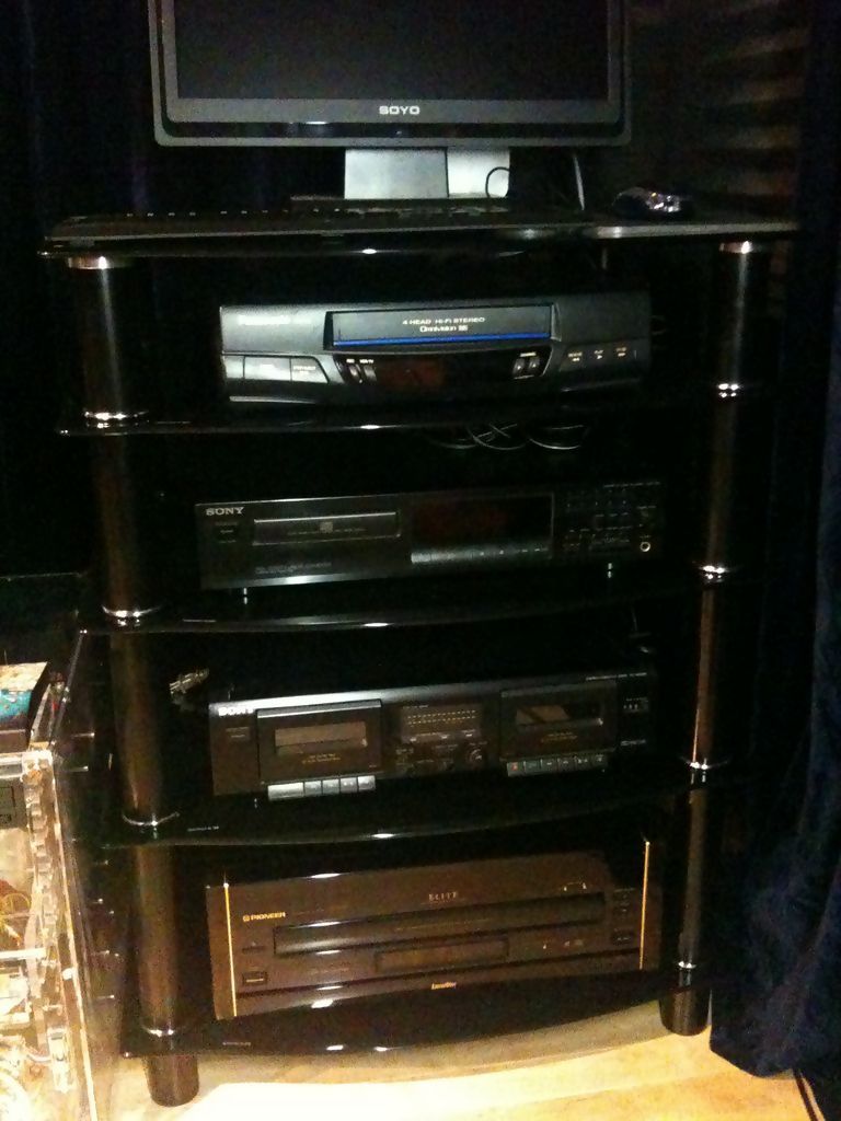

New racks setup. Removed the old taller one and now I have 10 shelves to play with! I like this setup much better.
Uploaded Oct 09, 2011 14:48:01
I guess you could call this the "old" rack. VHS, tape, laserdisc.....

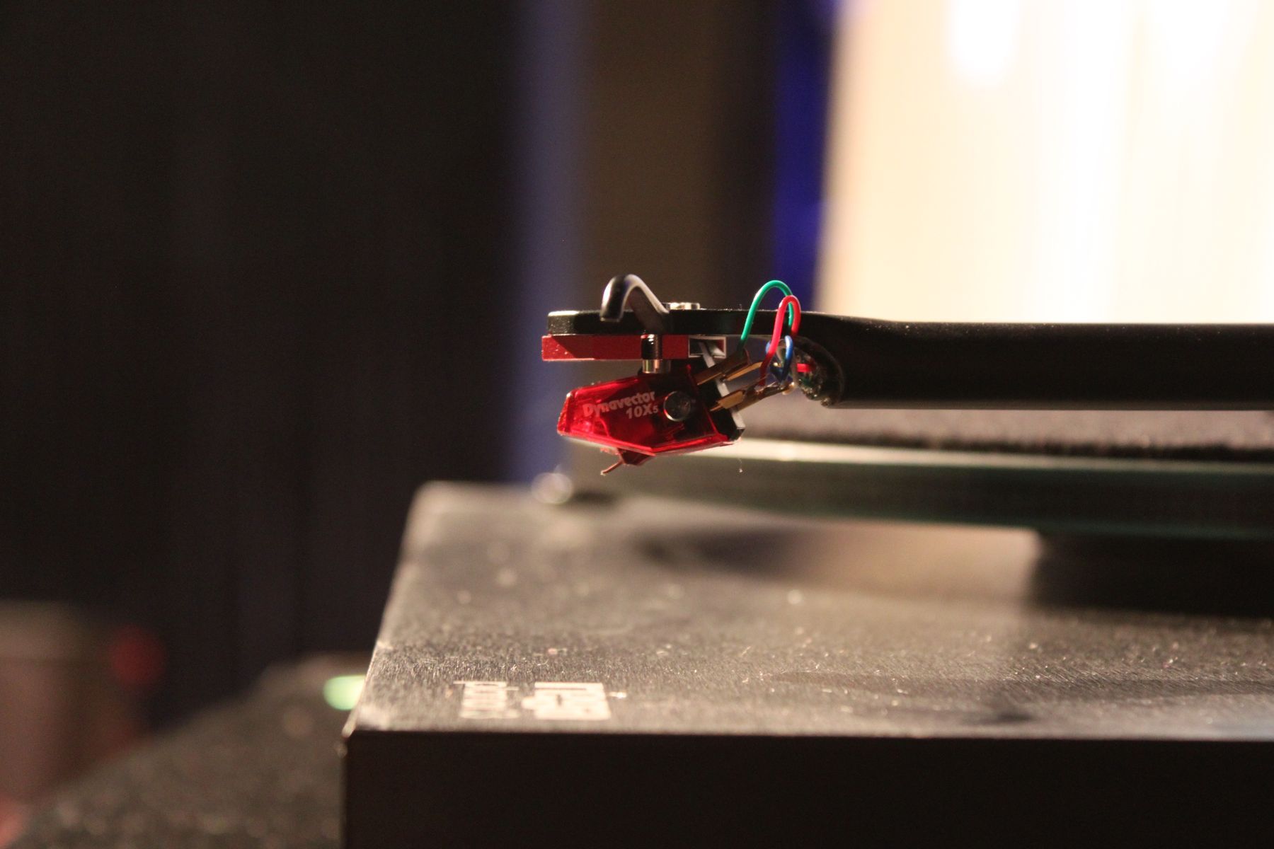

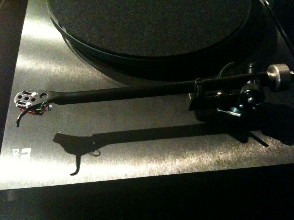

The classic Rega RB300 tonearm

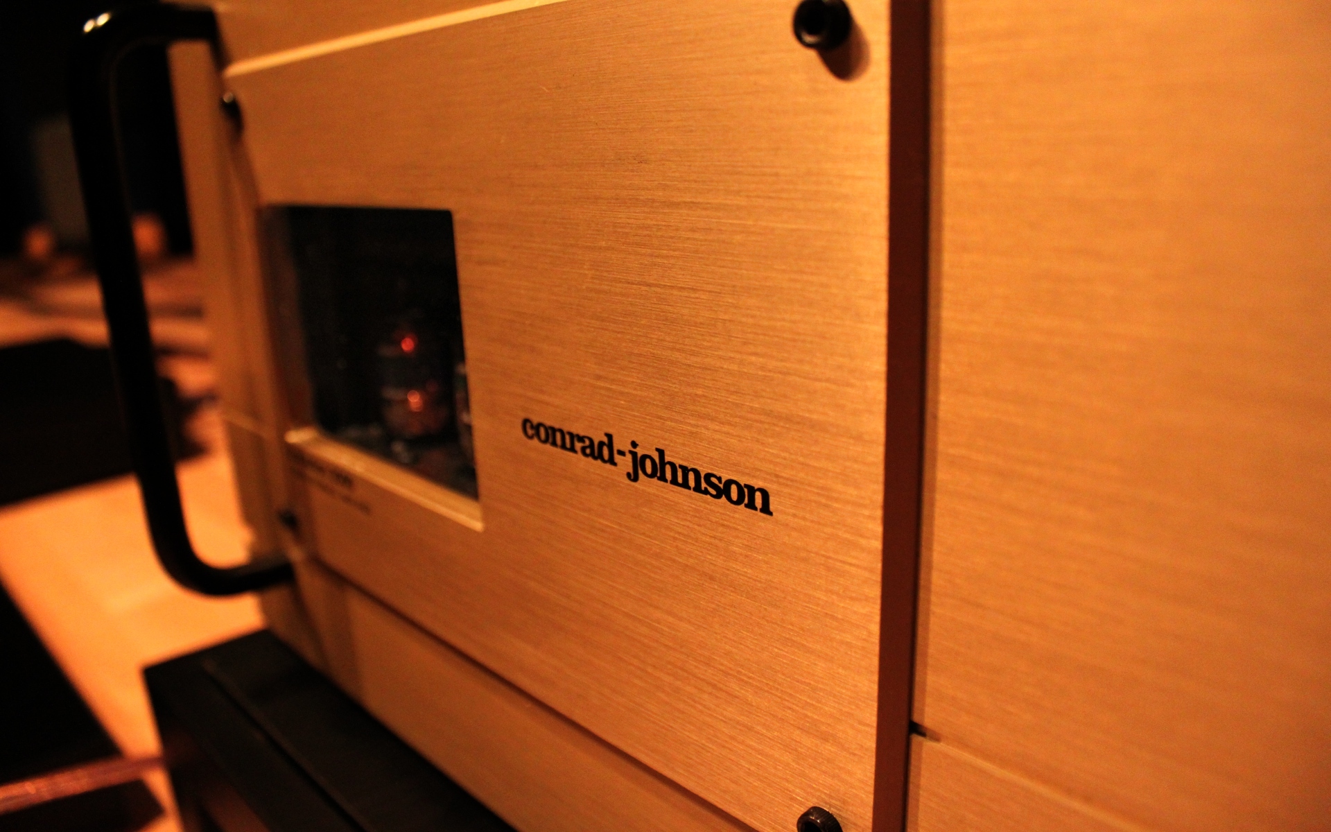

Conrad Johnson Amp

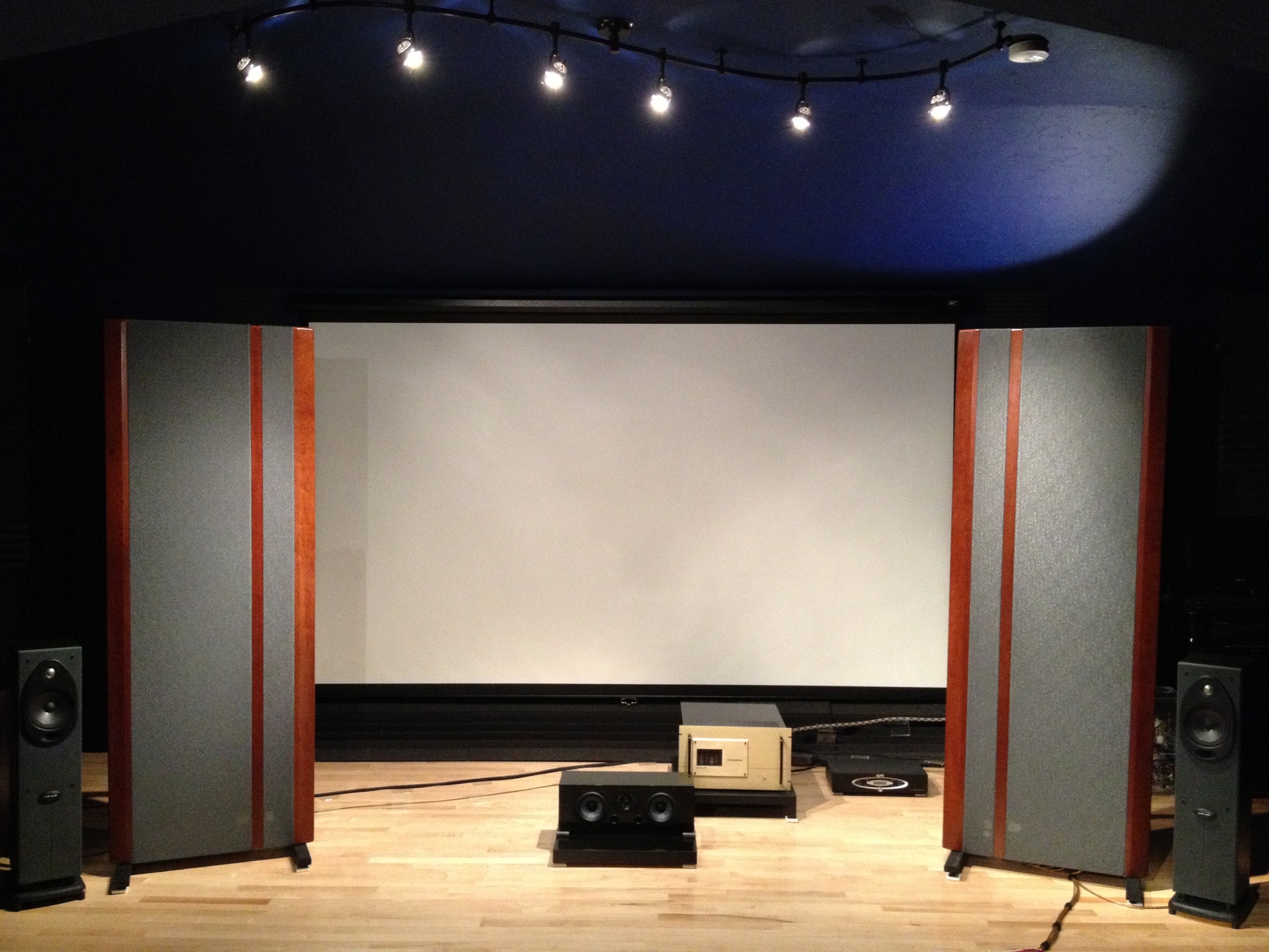

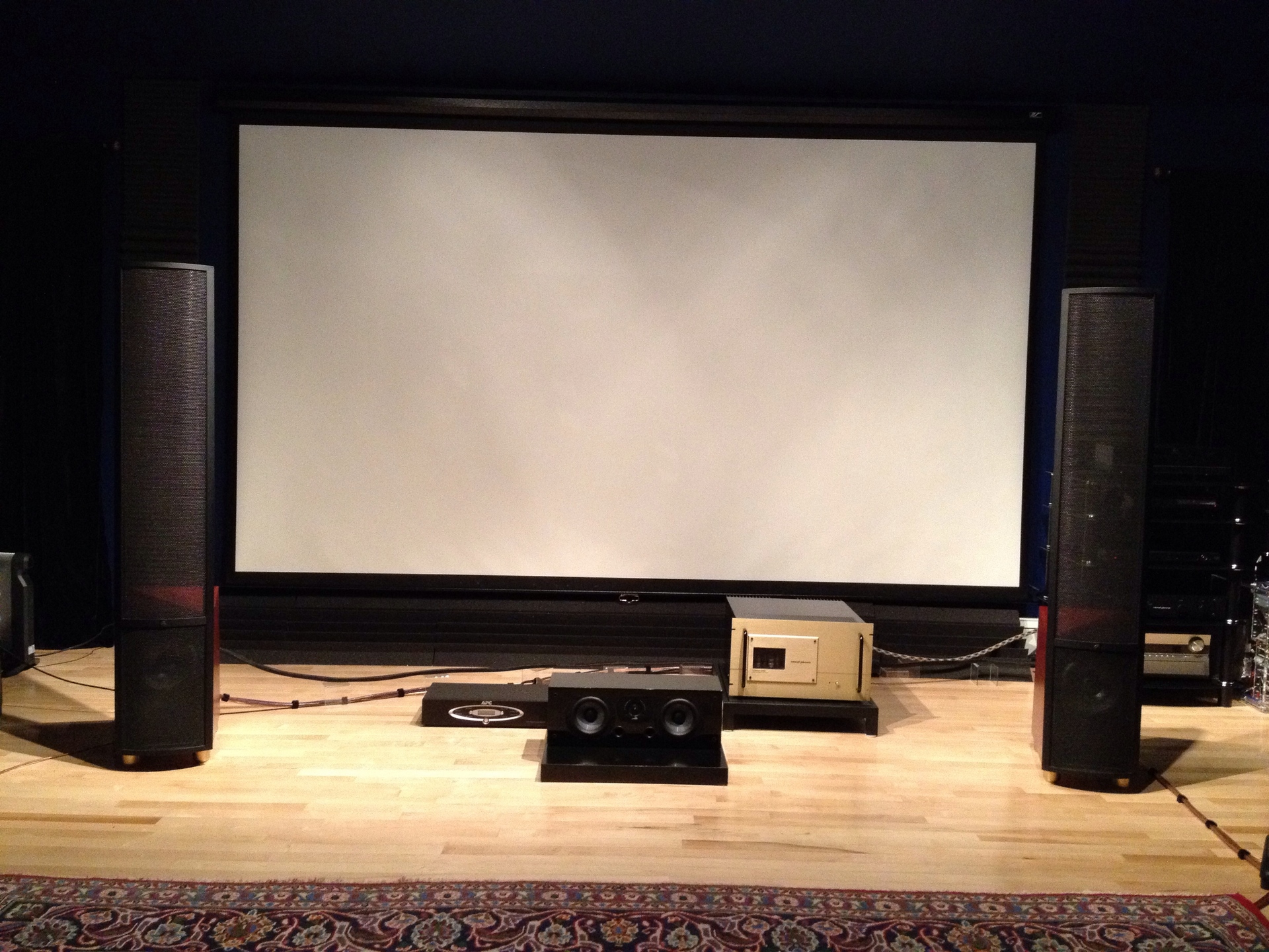

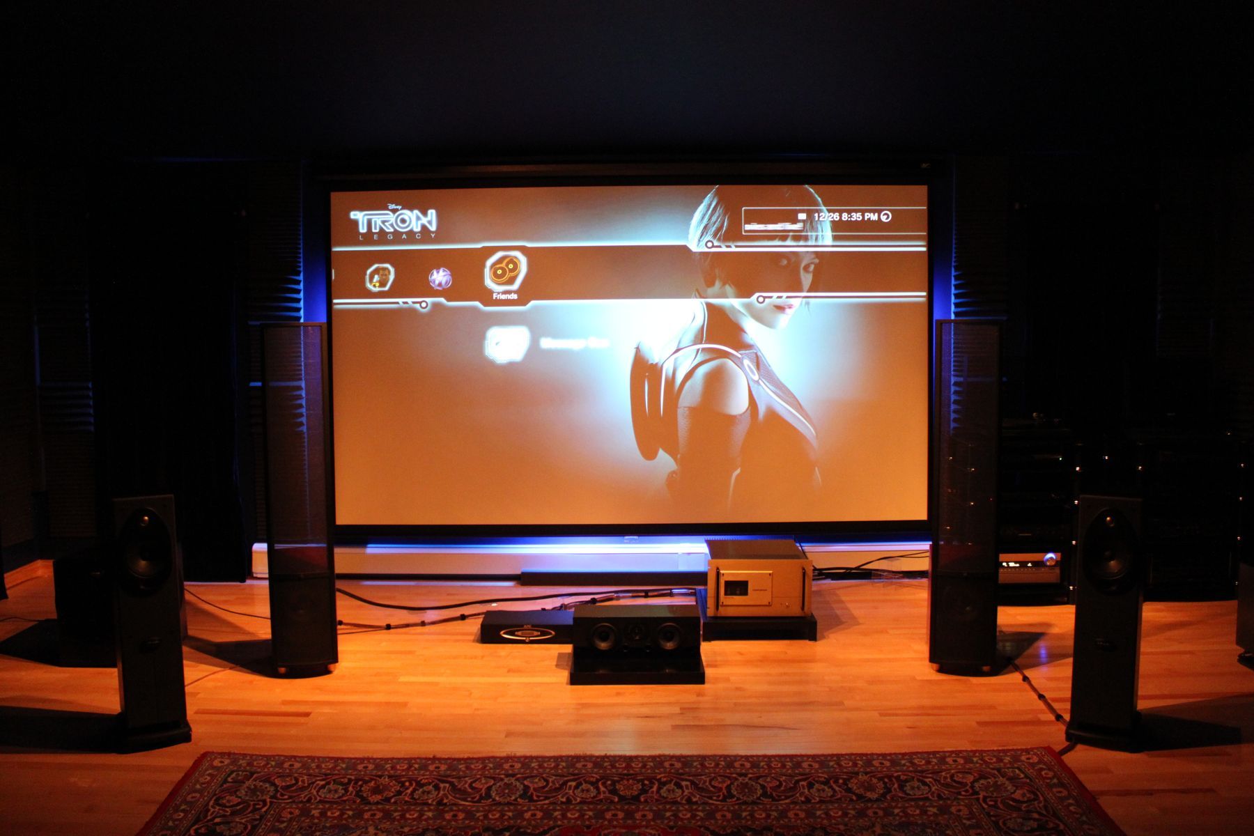

Upgraded the main Speakers from Martin Logan Vantages to highly modified Magnepan MG 20.1's with custom bases. The upgrade is truly magnificent sounding!
